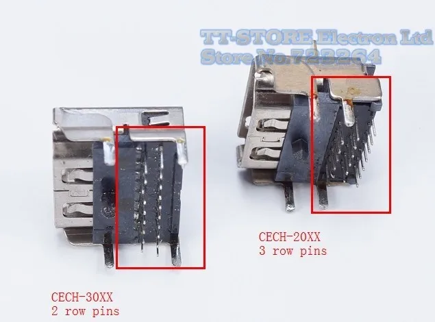

i also had mine replaced like 2 years ago, IIRC theres 2 versions of hdmi ports all fats and some slims share the exact same hdmi port and later slims and super slims share the same, i know because i saw the replacement on mine being taken from a super slim
according to that pic which is the only one i could find that showed both, those are the differences
and by just lookong at the underside of the mobo pics from the dev wiki you could take one out from up to a 25XX (JSD-001)
30XX and up are 2 rows which is what mine has
