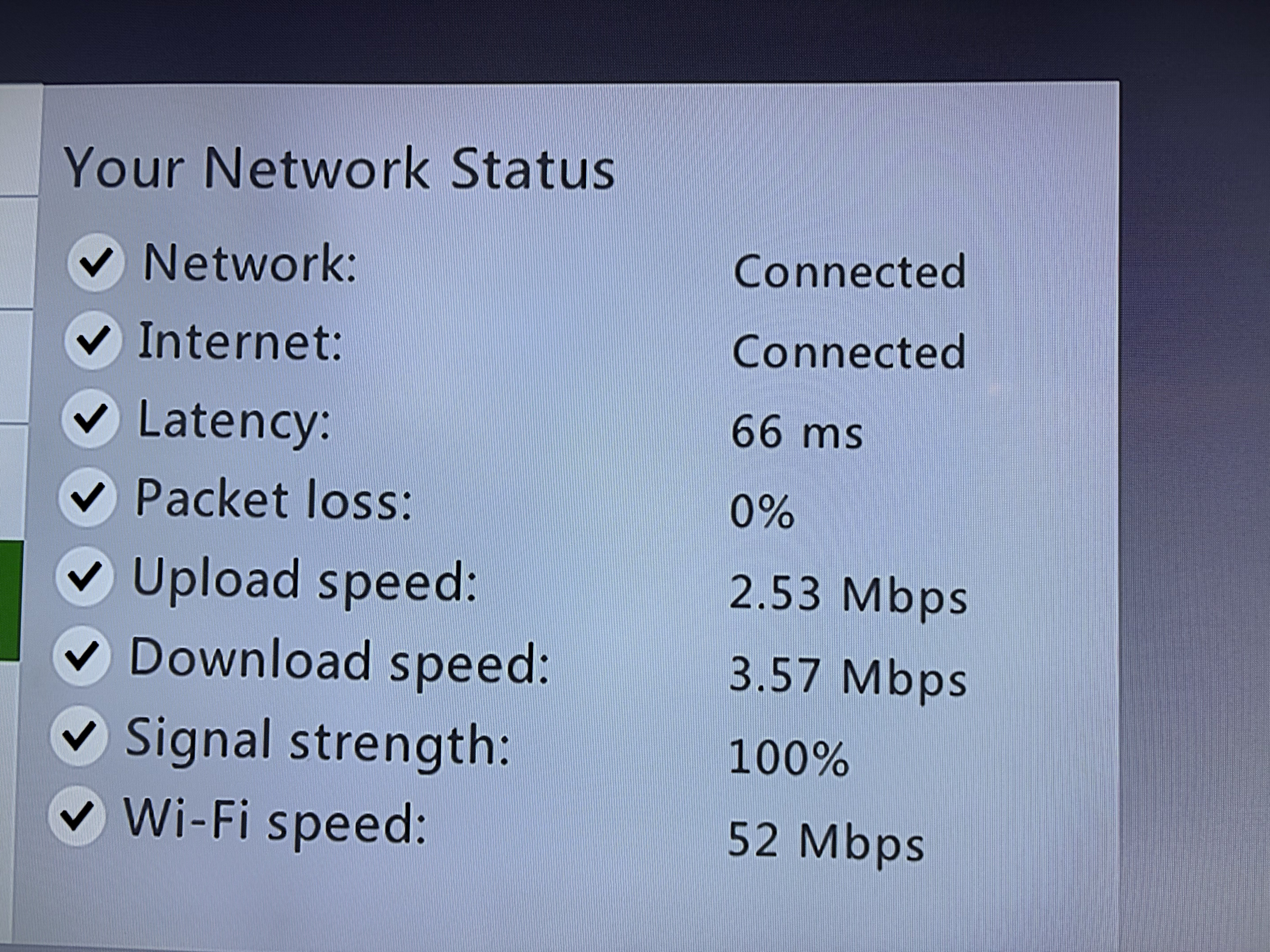

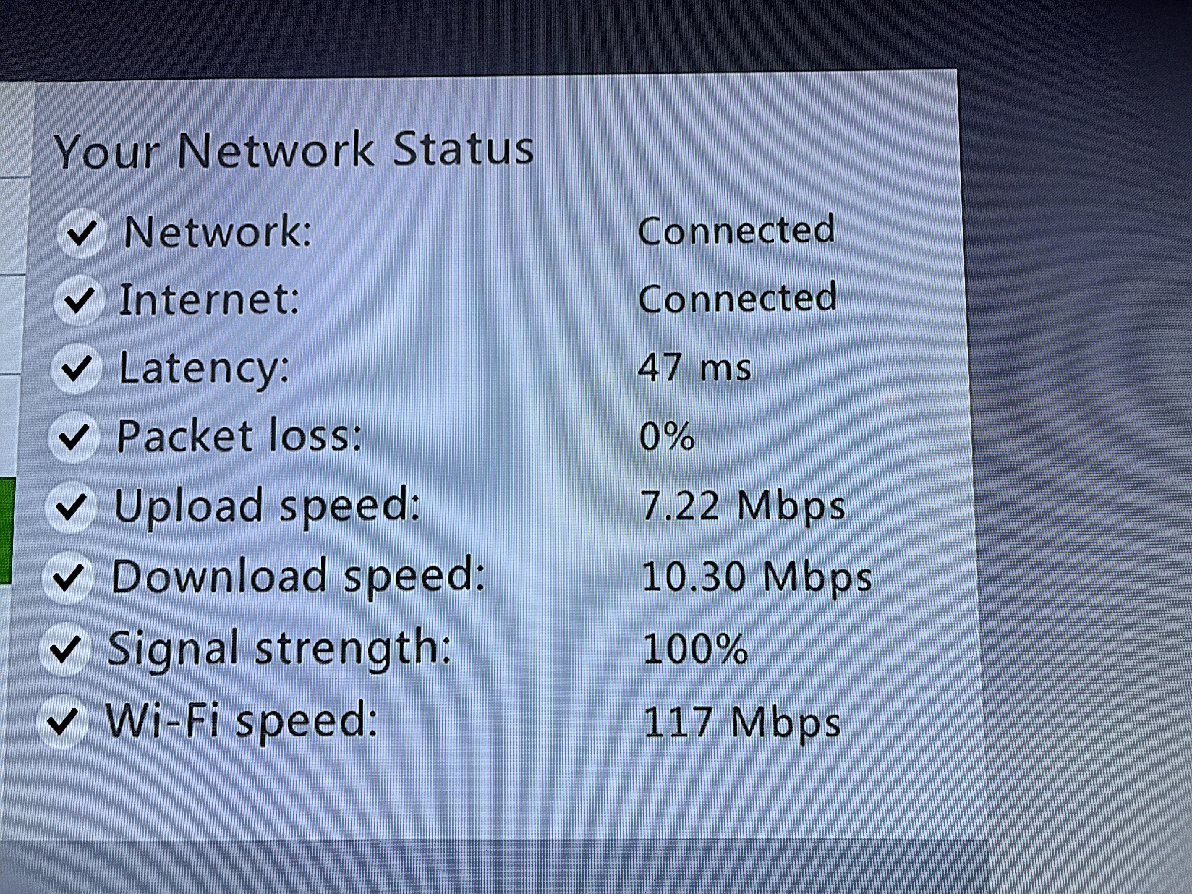

So here's the results. I used the Network Statistics option built into the stock dash multiple times until I got the best results since they can vary for both scenarios (no wireless N 5ghz dual band adapter and built in WiFi). I also turned off the console before plugging in the usb WiFi adapter (not sure if it matters or not).
Built in WiFi (Best)
Microsoft Wireless N Dual Band 5GHZ USB (Best)

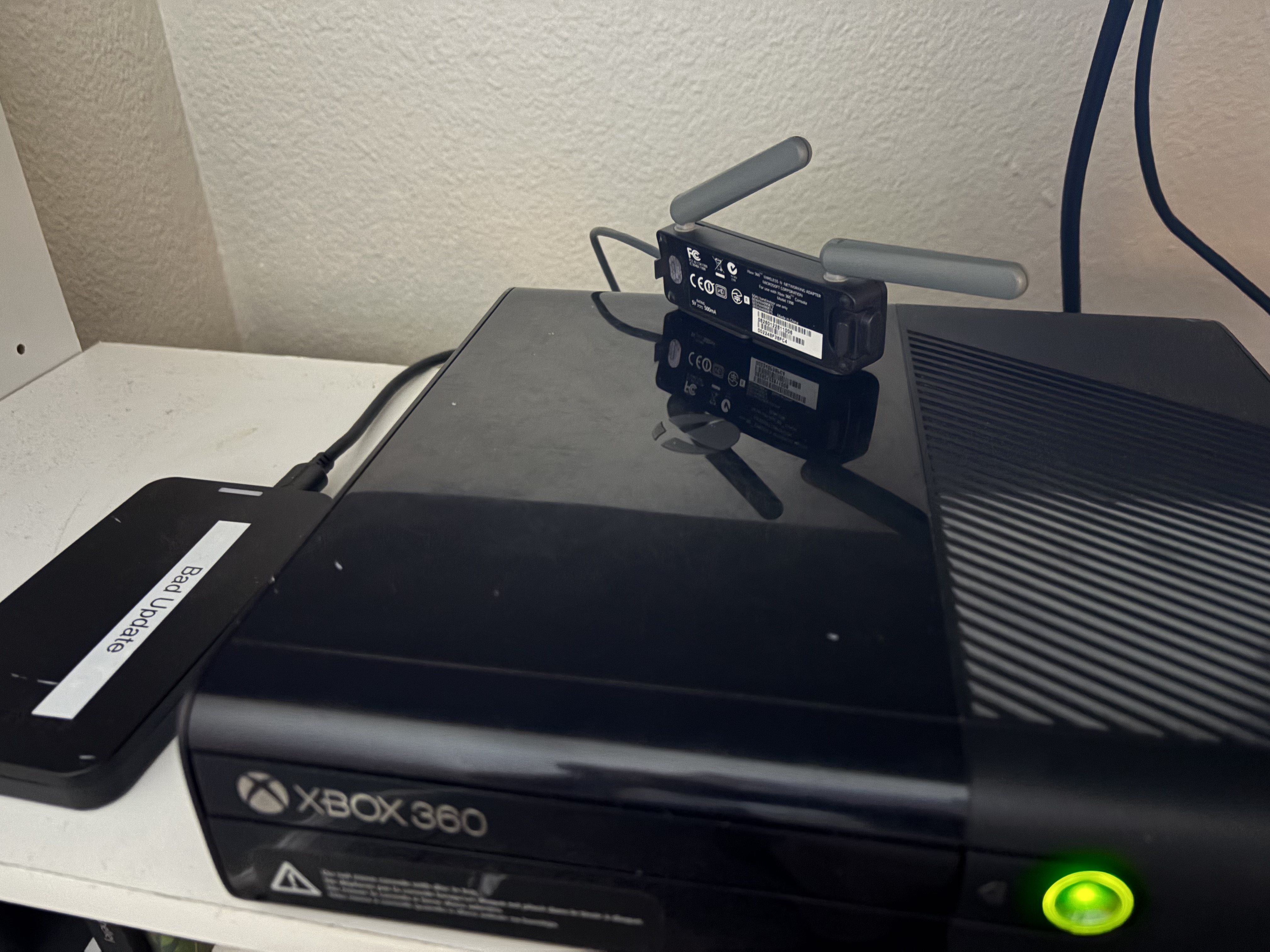

Setup:

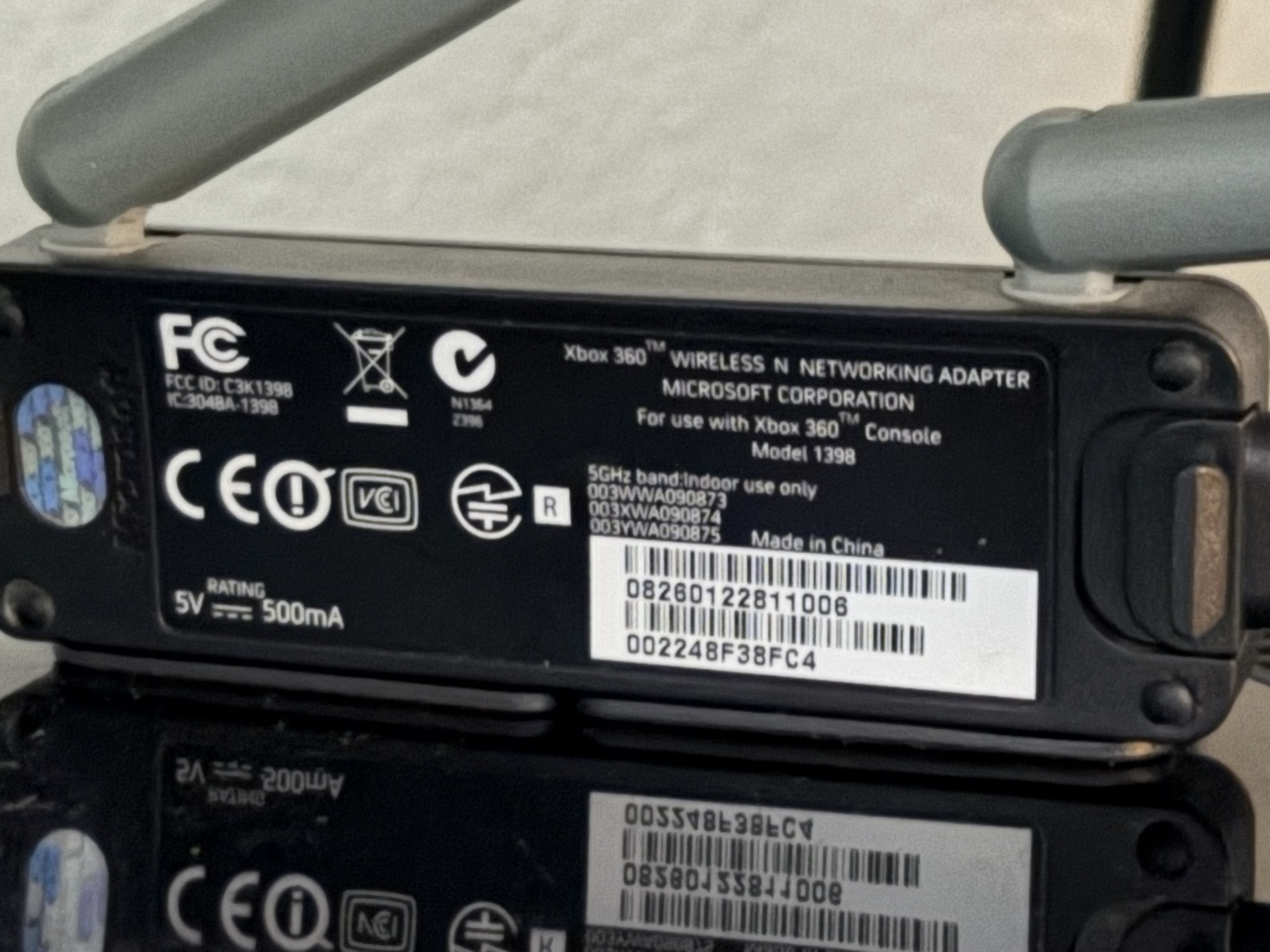

This is the one you want (with 2 antennas, not 1!):
The grey one with one antenna is the older 2.4GHZ model that is the same as what is already in a slim or E console.
Moving the antennas towards the router tremendously helped to get to these speeds as well
