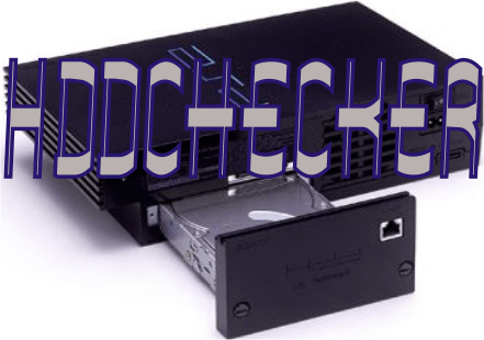

  • HDDChecker is a basic disk diagnostic tool meant for testing the health of your PlayStation 2 console's Harddisk Drive unit.
    It has the following features:
    1. Detects and lists the model, serial, firmware and S.M.A.R.T. status of HDD unit 0 (Primary Master).
    2. Performs a surface scan of the disk.
    3. Supports 48-bit LBA disks up to 2TB.
    4. Performs zero-filling of the disk with large blocks.
    5. With the surface scan, bad sectors found might be remappable. Based on my research, it appears that writing to a to-be-remapped sector (those hard-to-read sectors, as recorded by the disk) will kick off the actual sector remapping process. However, this has not been widely tested.
    6. Checks for damage to the APA scheme and PFS partitions.
    7. Defragments the HDD to reclaim space.*
    *Does not support disks containing HDLoader games.
