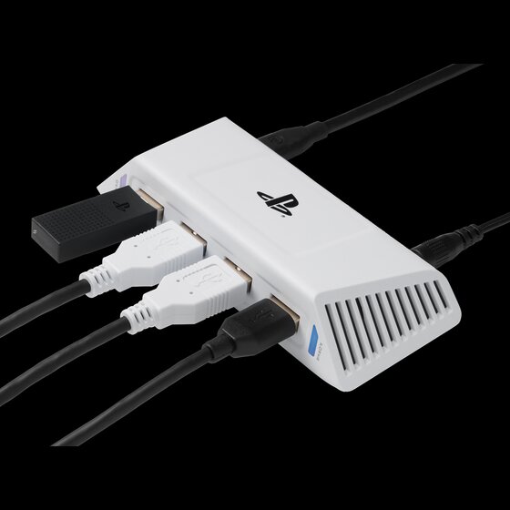

EDIT: I bought this powered USB hub for the PS5 and I have to use a travel adapter to fit it in my wall socket since it has an US power plug and I'm in Portugal but now I have an annoying whistling noise when it's connected to the power strip even after disconnecting the other devices from both power strips (one is connected to the other one and the other one is connected to a wall socket) and the DualSense and PULSE 3D don't charge if connected to some of its USB ports while the PS5 is in rest mode, which is odd. Also, this powered USB's hub "POWER" indicator is always on and I can't turn it off unless I click the powered USB hub's power strip's switch (for instance). I previously bought this unpowered USB hub for the PS5 but the DualSense and PULSE 3D didn't charge if connected to it when the PS5 was turned off unlike with the other USB hub (though the latter sometimes doesn't charge them) since it's not powered but at least it didn't make the whistling noise.
