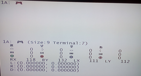

Thanks for answering. Yes, I just tried the controllers with the pdatest.elf and everything works great, except the vibration. I also connected the second DualShock controller to test it, but apparently it only shows the parameters in the interface when it is connected in the first port of the console.
I attached an image of the pdatest:

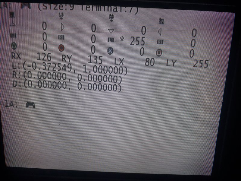

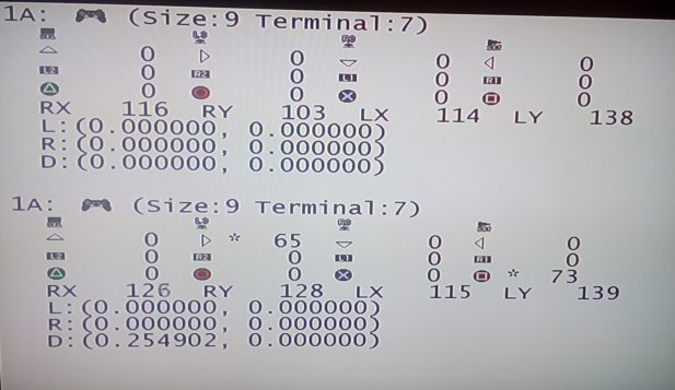

Here is how it should look like when 2 gamepads are connected:
Did you try to only connect gamepad to the 2nd port:
BTW I have noticed that in your uploaded image your gamepad in 2nd slot is not cross (X)
Maybe your gamepad slot (or ribbon cable) is somehow broken?

Thanks for answering. OK I think maybe the second gamepad slot of my console is broken, just as you tell me.

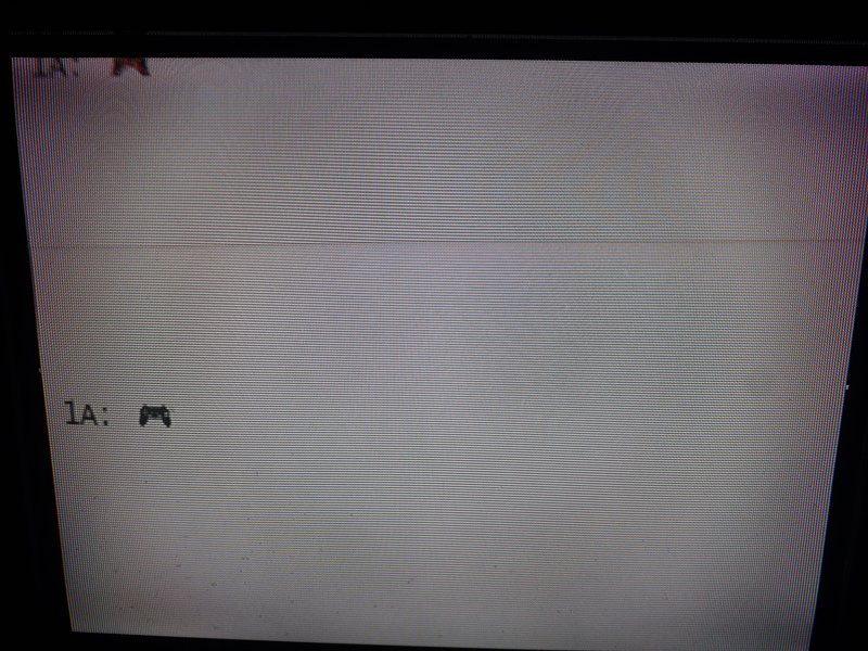

1. I test it again and it doesn't show me as you have on the picture, the parameters only shows it to me in the first slot of the console, but not in the second slot.
2. I Attached the following image of the PDATEST when connecting only the PS2 controller in the second slot of the console:
3. About the cross in the second slot, it was because when I took the photo of the program the first time, I connected a second PS2 controller in the second slot, apparently it does read the controller but doesn't show anything else.
Thank you very much, I have a better idea of what is happening. 2 years ago my console suffered a fall for a moving that I had, soon I wanted to turn on but it didn't work, so I took it to a technician to fix it and then it worked, but what I didn't get to try was the functioning of second slot of the console, maybe something it broke.
