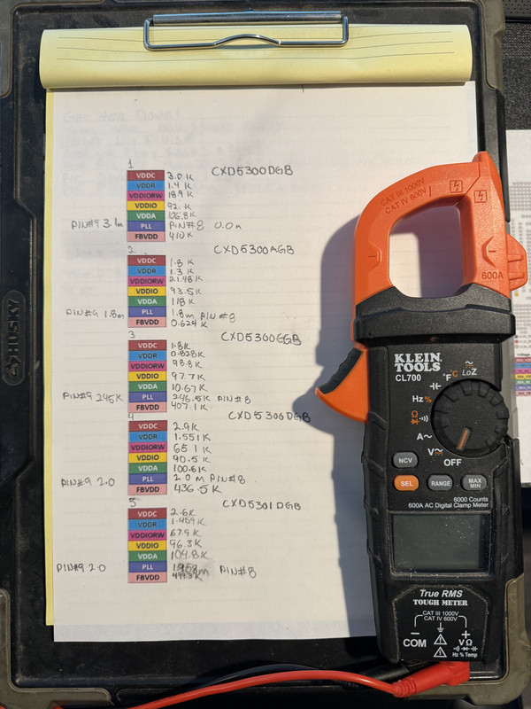

My CPU VDDC was 2.2 ohms, BE_PLL line was only 250k, MC_VDDIO 3.5K. Dead CPU? RSX measurements were good, both on and off the board.

Honestly I believe these resistance reading are worthless outside of open and shorts in various circuits. Ive installed chips way outside of the "good" values and they have worked fine.
+1 has a pll short and is bad, #3 is questionable with that low reading. Are those VDDC values correct? They should be 2-4 ohms not K ohms
lol yes ohms sry did this early this morning, tanxs
