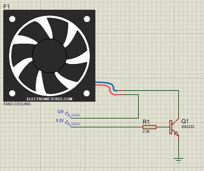

For 12V, i have designed this simple circuit. In the measurements, the console with the mains adapter delivered 5.2V and not 7V (SCPH-30000). The circuit uses the voltage from the fan's power port, to use it as a trigger for the 12V from the source. This allows the fan to not be always on when the console is in sleep mode (red "off" light).

The PS2 fan is automatically powered at a fixed 7V when the hard drive is connected, in my case is always connected. And no it is not powered when the console is in standby, so it is fine as I did with the DC-DC converter that lowers the 7V to 5V for the fan.
Just because a NA / HDD is installed does not mean the fan will get a constant 7v. My 39001 sends 5v until the HDD is accessed by the PS2 in which it sends 7v, and will drop back to 5v if the HDD goes to sleep. I'm considering Alfred0c's circuit for my current build (have both the 5v and 12v noctua 25mm, 5v installed currently), want to put a 15mm/5v Noctua in my next 39k.
Would DC-to-DC be a better solution to drop 7v to 5v than just a resistor? I imagine the resistor also drops the 5v down a little bit. It seems like it would negligible but I just want to install it the best possible way.
On the 30k and 39k series it is like this, but on the 50k (like the ones I use this fan in) it is not. Years ago I noticed that just the Network Adapter is enough, even without a hard disk, to "trigger" the 7V to the fan, so the fan speed is fixed and independent of what the hard disk is doing or if it is connected.

I used the DC-DC because I have a lot of them, so I didn't look for other solutions. In your case, however, you must take into account that when the PS2 powers the fan at 5V, both with a DC-DC and with a resistor the voltage will drop further and the fan could stop completely. Now I don't remember exactly the minimum operating voltage of the Noctua 5V, but I think it should be around +/- 3V, so you should decide accordingly. But if you want to use the diagram posted by Alfred0c previously I think you can skip this step completely. In my case, since the voltage is fixed, I didn't bother.
This is a mod that originally requires the use of a 12V fan and I believe that the choice fell on that model precisely to avoid this type of problem, given that it is mainly designed for the 30k and 39k.
