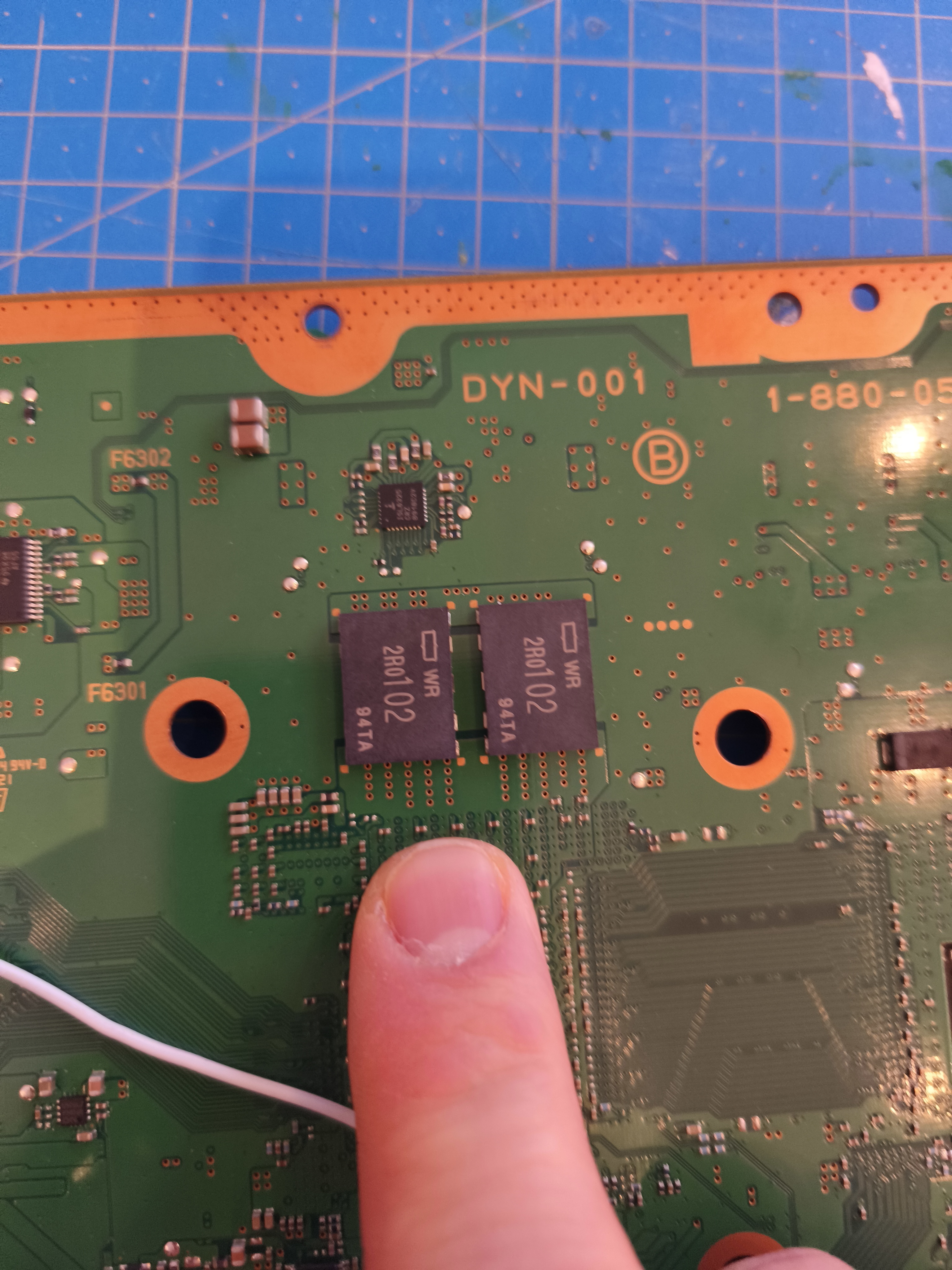

Hello, I'm completely new to this and this is my first attempt at repairing a PS3.
I bought an old, defective PS3 that has a YLOD (Yellow Light of Death).
The motherboard is DYN 001.
I took it apart and immediately noticed that it had been opened before. I then tried to read the error codes using SYSCON. This was more work than I expected, but I managed it.
Only one error is always displayed. Here's the log:

I've found out that this error is probably related to the TOKIN chips.
Now I wanted to take a closer look at them and try replacing them myself.
However, I've now noticed that they have probably already been replaced. Since the TOKIN logo on the component isn't the usual NEC TOKIN logo, but something else is printed there (see picture):
WR 2R0 120 941A
Google also tells me that these aren't the original parts: "Based on the query and common PlayStation 3 (PS3) repair terminology, '2R0 102 941A' refers to a specific component used to fix the Yellow Light of Death (YLOD) on PS3 consoles."
My question is: Is it even possible to replace the TOKIN (WR 2R0 120 941 A) again? Since it's already been replaced once. Or could it be something else?
If anyone has any ideas, please let me know.
Thanks :)

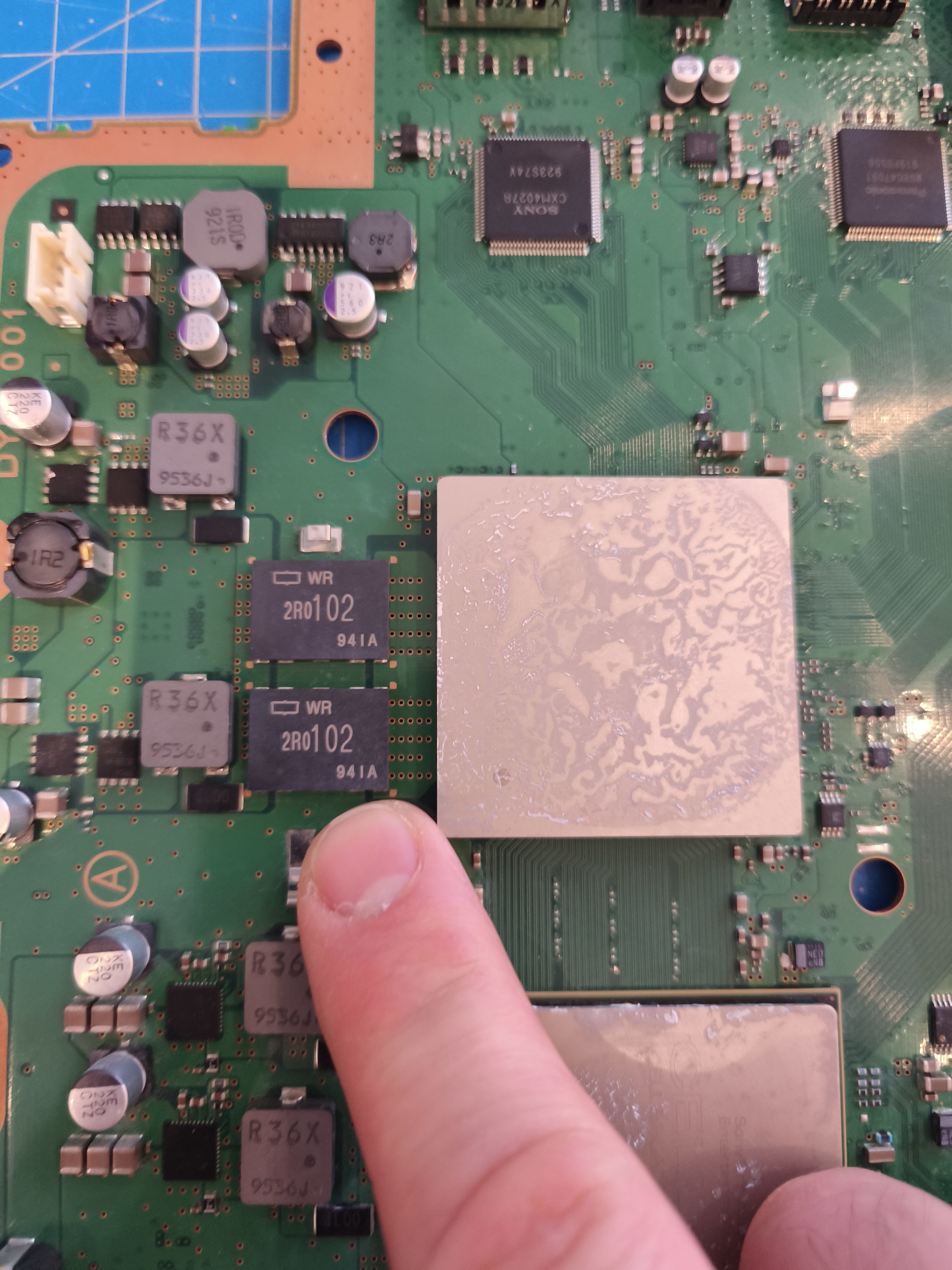

I had similar error code with ylod and I replaced the nec tokins, which were the original, I now getting 1201 which according to google, "PS3 error code 1201 indicates a critical RSX (GPU) processor overheat issue, often causing the console to shut down immediately with a yellow or red light (YLOD/RLOD). It is commonly caused by dried thermal paste, excessive dust, or a failing fan. Immediate solutions include cleaning, replacing thermal paste, or checking the PSU for unstable voltage". Now its start momentarily the fan ramps up and shut down within seconds. In you case try to change the ones on board and you can only try and see the outcome. In may case I think it is the RSX but could be wrong. Perhaps someone can tell me what is going on. I am new in the posting department.
Southbridge reading I am seeing this
ûBoot Loader SE Version 4.1.1 (Build ID: 4710,48878, Build Date: 2012-02-11_01:04:53)
SDK Version: 411.000
Copyright(C) 2012 Sony Computer Entertainment Inc.All Rights Reserved.
[INFO]: === eXtreme Data Rate Memory Subsystem ===
[INFO]: (Configured Memory Size per single XIO channel: 128 MBytes.)
[INFO]: XIO channel[0] is available.
[INFO]: XIO channel[1] is available.
[INFO]: ---> Total 256 MBytes are now in use.
[INFO]: SPU enable [0, 1, 3, 4, 6, 7] 11011111
[INFO]: BE:3.2, SB:DX3.1
Device: PATAC0:Cable Not Connect
Cell OS SDK4.1.1 000 (release build: r48878 2012_02_10_235900)
Copyright 2012 Sony Computer Entertainment Inc.
revision: 48874
date: Sat Feb 11 01:10:01 JST 2012
skip 2nd initialization step
