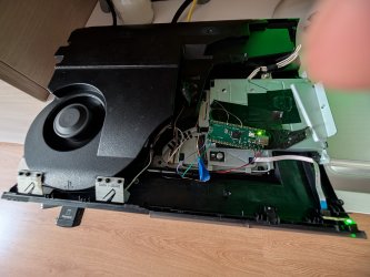

- If not already, Install the modchip by following Installation (Hardware) section
- After modchip installed and power plugged in, wait until LED of modchip becomes solid. If it doesn't solid after a while, check SC_RX/SC_TX wire
- Turn on the console. modchip LED should flash briefly with triple beep right after. This means exploit is successful. If your console keep turning off and on, check CMD/CLK wire and Stagex
- You should be on XMB now. now Enable HEN then use Install qCFW option
- If it tell you to reinstall firmware and try again, do it ONCE.
- Your screen will appear frozen. it is installing. This process take 10-20 minutes. If something goes wrong during this step, you should be still able to recover by entering safe mode and reinstall firmware normally
- Then it will reboot itself. you should be on qCFW and see Evilnat logo now.
- Congrats! qCFW installation is complete
- From now on, modchip will be required to boot the console until you go back to OFW again

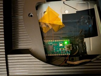

.Currently, Raspberry Pi Pico (RP2040) and RP2040-Zero are supported.
- Only install modchip after Stagex is installed to console flash from above section.Otherwise it won't boot,
- if you already installed the modchip, You can use HOLD pin to temporary disable the modchip without unsoldering it.

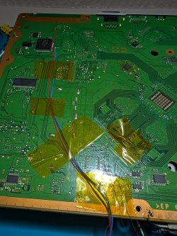

Since I don't have 2500 and 3000 model to test, it must be done by other people. If you know the solder location please tell me. Thanks.
Pico
RP2040-Zero
3000
4x00

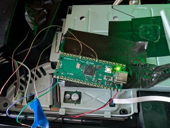

- To flash .uf2 file (it is included in qCFW zip), simply connect modchip USB port into your PC while pressing BOOTSEL button. Then new drive will appear, simply drag .uf2 file into it.
- You should see LED blinking. Flash successful and ready to use. You can disconnect it from your PC.
- Exclude power and ground, you only need to solder 4 wires that marked red (CMD, CLK, SC_RX, SC_TX). Other pin is optional.
- It is possible to power the modchip using external power as long as it is active during ps3 standby
