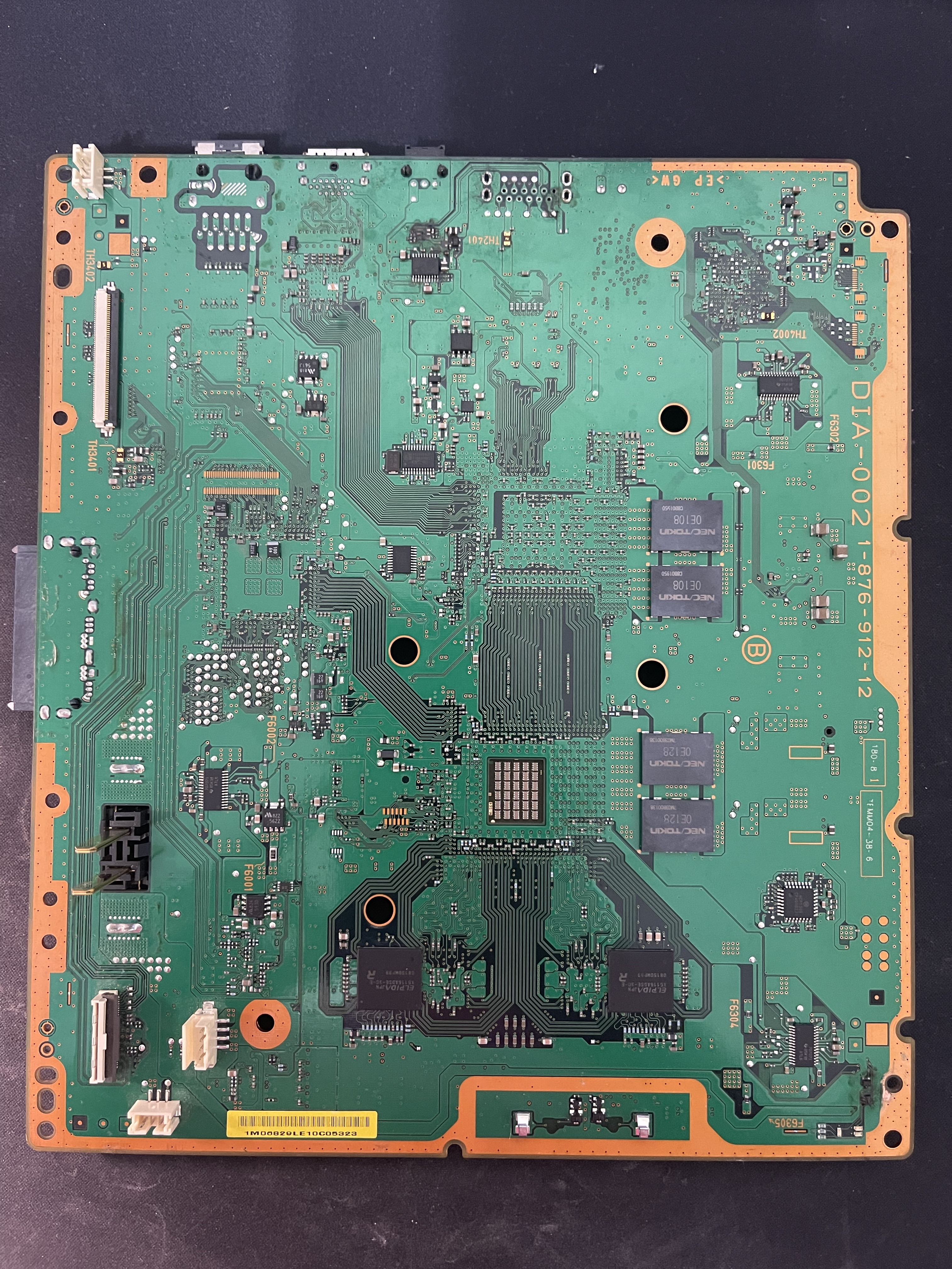

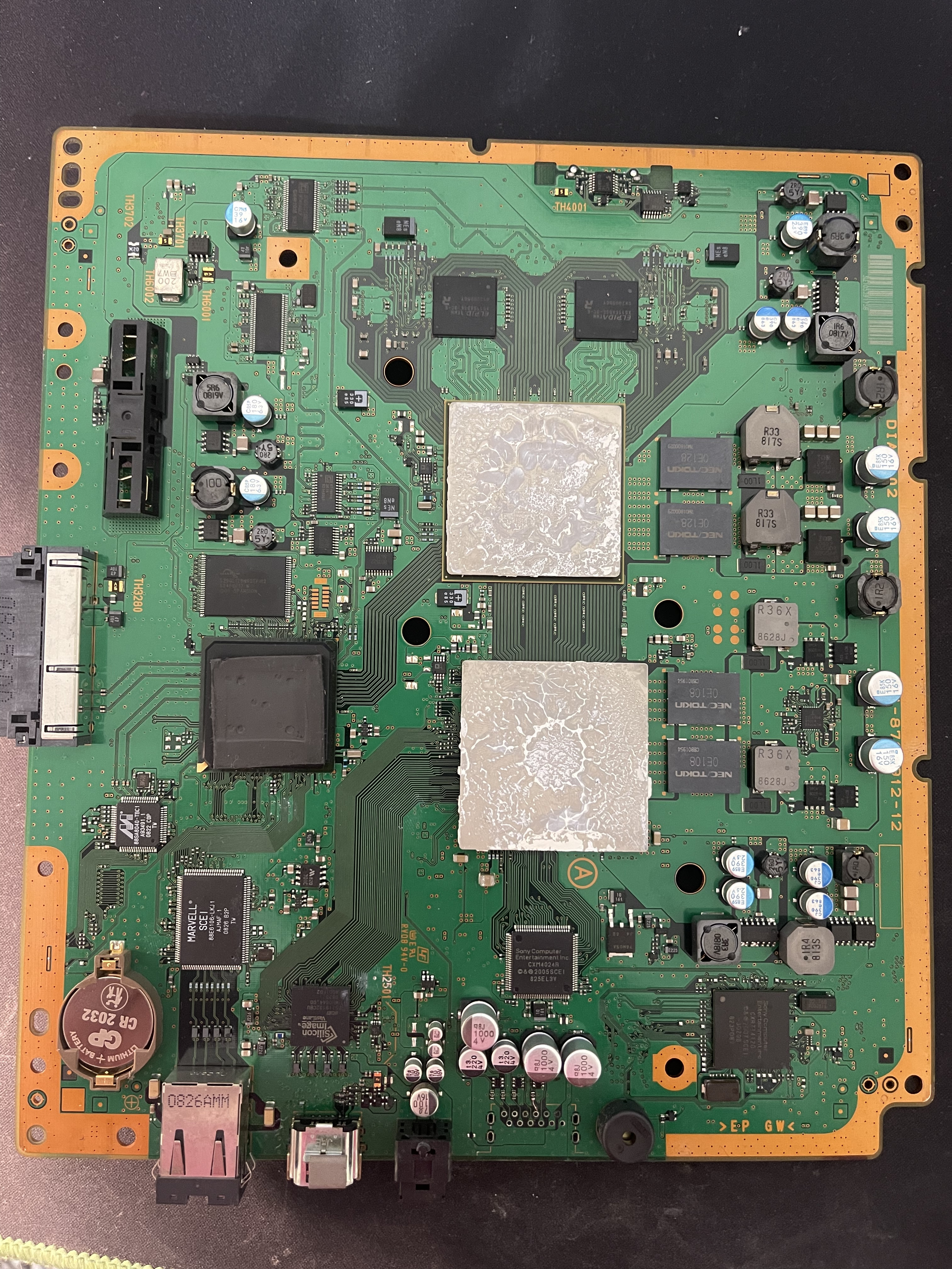

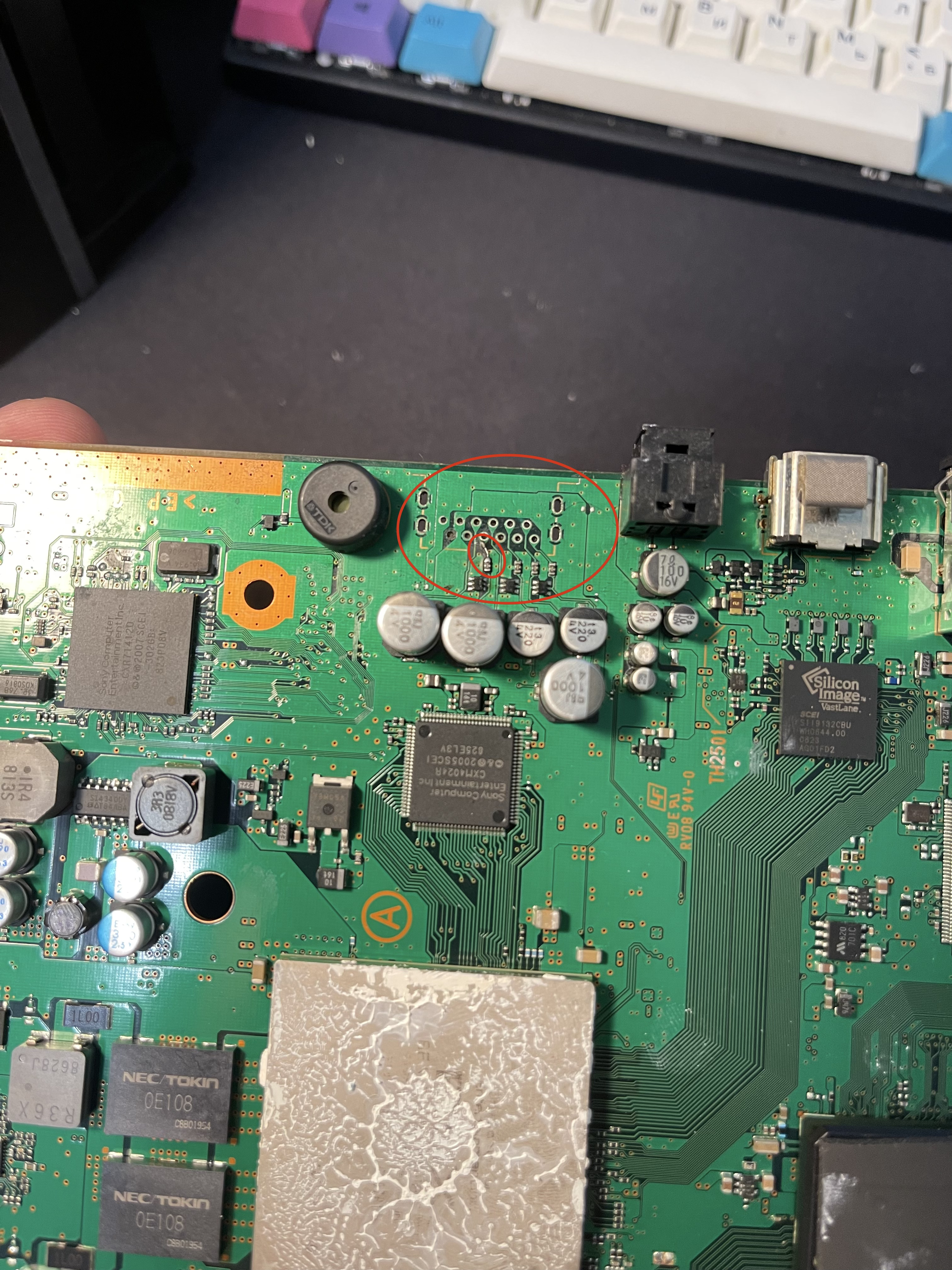

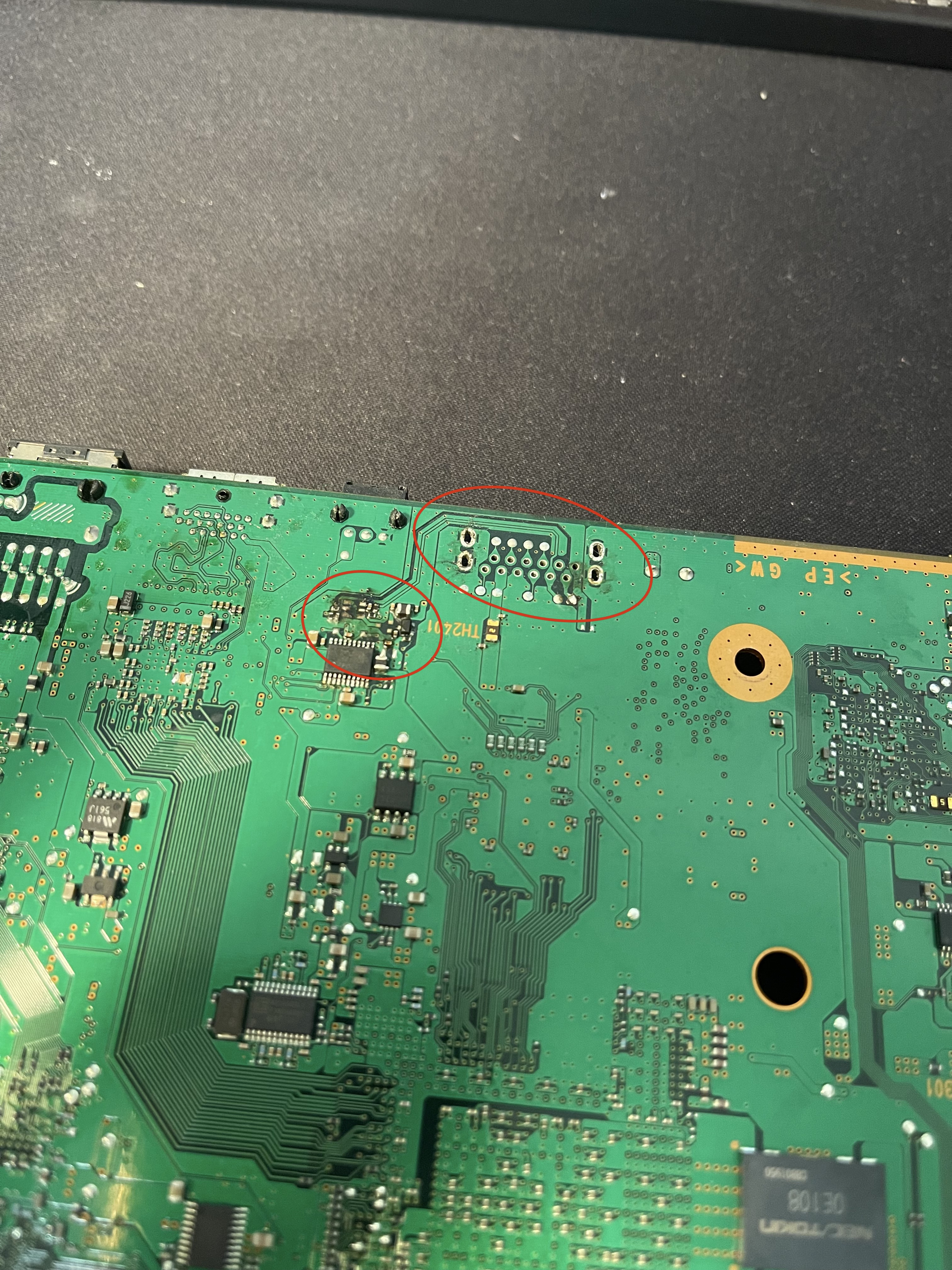

I have a PS3 Fat cechk. No red light, power, sound, and buttons are not responding, even though the power is on.
Power cable is working(tried on another working ps3), also tried new PSU(EADP-300AB) but no luck, still no red light and power. Checked the white cable that goes from PSU to Motherboard(DIA-002) and its working (showing 5v).
So i guess the motherboard doesnt get power from PSU, and i dont know how to find the problem on motherboard.
Could someone help me find the problem?
